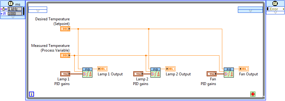

If you want multiple PID controllers to regulate temperature, you do something like this:
Does this help? Is this example complex enough? What do you find unclear?
