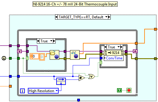

Hi Folks,
Is it possible to change the Conversion Time on running modules?
My attempt (shown below) failed (cRIO hangs) when switching from the default "High Resolution" mode to "High Speed" mode.
Are there any other options?
steve

Hey Steve,
It is possible to change the conversion time of your NI 9214  at run-time using a module property node.
Please take a look at the next KB. It talks about changing the Conversion Time programatically and shows a way to do it.
http://digital.ni.com/public.nsf/allkb/3677FADAE926187C86257CBD0066BC76?OpenDocument

Thank you for the link TwinTwo !
I will update this thread when I test the work around.
