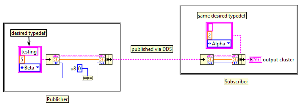

We encountered this problem in the past and our workaround was to cast the enum to a u8 and pass an intermediary cluster through DDS (i.e., exactly the same as the initial cluster but with the enum in the cluster substituted with a u8) and then cast it back to the expected cluster type on the other side. Obviously this creates some coupling between applications since your definition of the enum is not being enforced by the DDS QoS, but sometimes you unfortunately have to do something you don't like just to get something to work.
We're version locked on 2.1.1 of the DDS toolkit, which is a few years old, so maybe it's natively supported now and the intermediary step isn't needed. RTI should be able to answer that question.
note: I know that cluster is not a typedef, I just put this together for illustrative purposes
