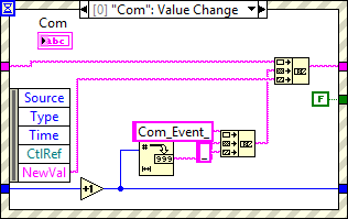

In your event loop you're just using the reference to the control to get the value.  Stop using that, and start using the "NewVal" terminal from the event (it's currently hidden, you need to expand your event variables or change one of the existing ones to it).
Because the lower loop runs at a higher speed than the upper event loop, the events are reading future data, effectively.  The "CtlRef" terminal there is not frozen in time, it updates with everything else.
