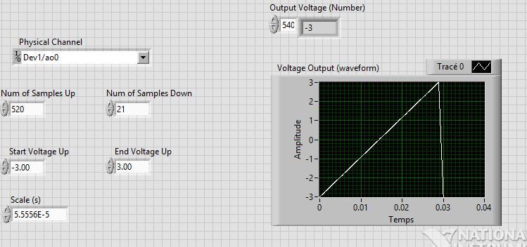

I am very new to Labview and I need some help here. Part of my aim is to generate a ramp signal for my scanner.
I searched the forum and found an answer which is not a bad fit for my aim (attached below). I have two questions:
1. according to my understanding, the ramp by sample vi does not have anything to do with the infinite or finite samples, only DAQmx timing vi determines that. So if I change the finite samples to continuous samples, theoretically I should get the infinite ramps until I stop it. Is that right?
2. If I want the ramp (down part) goes down gradually (in this example, the down part is a purely vertical line, which means the voltage will go down from +10 v to 0v very quickly. And this will lead to mechanical problems to my scanner. ) How should I change the code?
Welcome to any suggestion! I appreciate the help in advance!
Yes, the DAQmx timing determines the timing for the output. That is taken from the dt of the waveform. For a continous output you have to change your VI, esp. you'll need a loop where you can stop your output. I suggest that you have a look at the examples in the NI example finder, there should be something for continous analog output there (cannot look up for myself currently as I don't have DAQmx installed).
You could add another down ramp. How to do this? Look up in one of your old threads, you already got that answer...
Regards, Jens

Thank you, Bob! The problem is the equal rising and falling time is maybe not what I want. So I guess triangle signal may not be ideal in this situation.

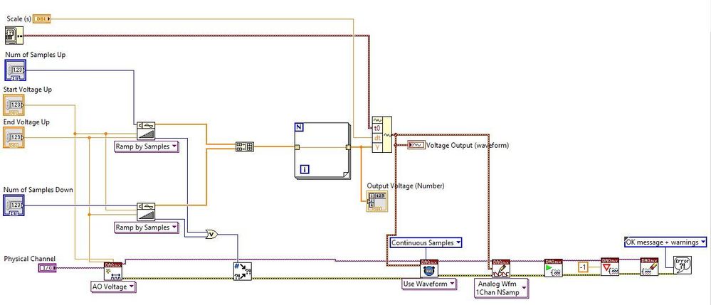

Thank you, Jens!
I have updated my vi and attached a screenshot.
My current question is: since I want continous ramp, so I have a for loop for it and a waveform vi to observe in the front panel. However, I dont see the ramp continuously going. So how can I make sure that the ramp is continuous instead of being generated only once?

Don't confuse your front panel indicators with the behavior of the DAQ device.  Your VI only executes once, thus only the buildup of the single triangle wave is shown.  But your DAQmx is set for Continuous Samples and wait forever, so the DAQ card should be outputting that waveform over and over again.
One problem you have is that the only way to stop the program is to abort the VI and that means the DAQ task clear will never execute.
(4,389 Views)
Thank you very much for the answer! I used an oscilloscope to read the signal I generated. It's continuous ramp!
