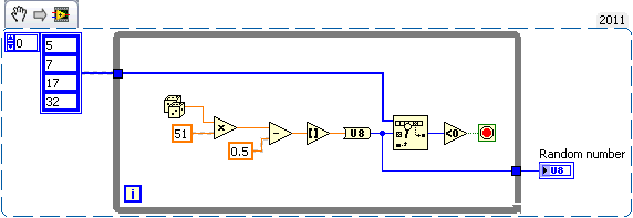

The code by Christian will have a smaller probability for the values 0 and 50 than for the other numbers. Your range covers 51 numbers so you have to multiply the random number by 51, then subtract 0.5 before rounding.
Also, it does not check if the number is in the array.
You could do something like this.

Christian, your are still not generating integers (blue) and your random number are still not really random, because 0 and 50 only occur with half the probability of the other numbers. You would get fired from any casino in Vegas!. 😄
You need to multiply by 51 the round to -infinity as in my example above.
