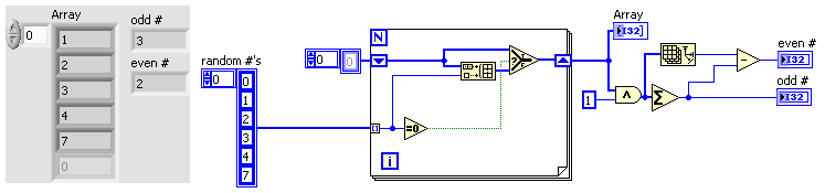

@apok wrote:
@RavensFan wrote:
Spoiler
Create the array.  Use quotient remainder to divide by 2.  Now you have an array where all the odd numbers are now 1, and all the even numbers are now 0.  Sum the array and you have the total number of odd numbers.  The number of evens will be the length of the array divided by the # of odds.
"The number of evens will be the length of the array divided by the # of odds."......you mean subtracted not divided?
Yes.  I think I had divided still on my mind from talking about the Q&R function.

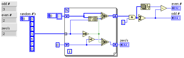

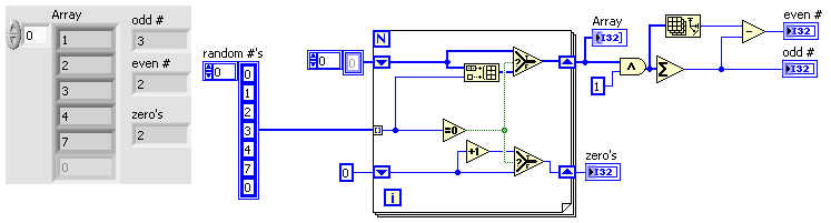

i revised my last post to include the # of zero's...
Spoiler

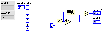

As has been said, zero is an even number, so I would suggest not to escalate the issues by adding complications that are not requested.
Here's all that's needed. (I included the random generator, because many users take shortcuts that give lower probabilities for the first and last element.)
sorry for the mis-direction on my part,"excluding zero".....
Spoiler

Thank you very much!
This is exactly what I need, I can´t thank you enough.
