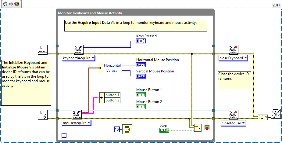

Of course, if we look into the example finder.....
We get this
Message 16 of 26
(3,492 Views)
We get this
Yes I knew about these functions, although I never used it before doing a little experiment.
First, acquiring the keyboard doesn't return a history of the keystrokes, but which keys are currently pressed. For example, sampling at 1 ms and typing 'ciao' I got a sequence like ccccccccccciiiiiiiiiiaaaaaaaaooooooo. The number of repetitions of each key was different, depending on the time lapse my fingers remained on the keys (although we may expect the reader would be more regular).
Second, the OP says that the operator will be working on something else, possibly pressing further keys. The Initialize keyboard vi does not seem to be able to discriminate between the two devices.
Paolo
