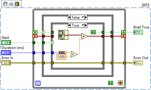

This is the Initialization part of a sub-VI I call "Brief True".  You put it whereever you want a Momentary True to "latch" for a period of time (another parameter to the sub-VI, default is 1000 msec).  If Momentary True is off and Start is True (illustrated), this saves the "Stop Time" in a Shift Register and turns on Momentary True.  Subsequent calls (in the Case not shown) just compare the Current Time to the previously-saved Stop Time and set Momentary True to "Current Time < Stop Time", ignoring the Start command.

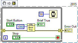

Here is a Test Routine that shows how this works.  The Start Button is a Latch When Released control, so it acts as a Momentary True switch.  The Brief True sub-VI turns it into a 1-second True indicator that we test 20 times/second.
You described doing this with an Error Line -- you could either simply use Brief True on the Status component of the Error Cluster or adapt these routines to use the Error Line instead of a Boolean Input and Output.
