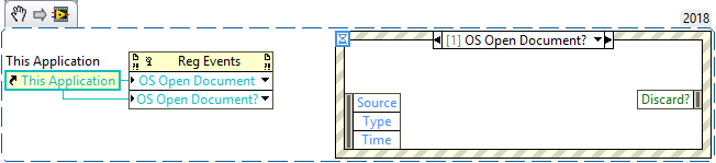

Did I enable something naughty?
Anyway, they are Application events... You might need to turn scripting on, or maybe some other key. Here they are, although I'm not sure how useful the static events are:

Hi wiebe,
That might be the reason I don't find them in my LV2017 installation.
Neither in the event structure nor at the RegisterEvents node…
(2,967 Views)
@GerdW wrote:
Hi wiebe,
Those two go together. I included the dynamic event registrations in the snippet so you can use the events without enabling scripting (or whatever I enabled). The event structure can be used of course, but it would not be possible to add to an existing event structure.
