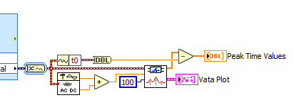

Hi Sukesh,
it seems you handle LabVIEW timestamps, converted to their numeric value:
When you need relative times instead you need to get the difference of two timestamps…

Hi Sukesh,
the WAMultiscalePeakDetector is a VI you can look inside. Did you?
If you would do so you would notice those "locations" are already scaled to t0+i*dt…

Hi Sukesh,
But I am not getting those values from WA multiMulti peak detector in the "location field". Kinldy let me what went wrong here.
There's nothing wrong. You just have to note the term "+t0" in the equation for those locations!
t0 is the number of seconds since epoch of the timestamp (as described in the LabVIEW help). That's why you get numbers in the range of 3.6E+9!
As written before: to get relative time you need to subtract two timestamps…

Hi Gredw
Thanks a Lot . I got it now and did the same modification in the code. I was not able to locate t0 values.
Now both xls and times from locations are same ...

Hi Sukesh,
try to minimize ExpressVIs and DDT wires as much as possible.
Convert from DDT to some meaningful datatype as soon as possible:
