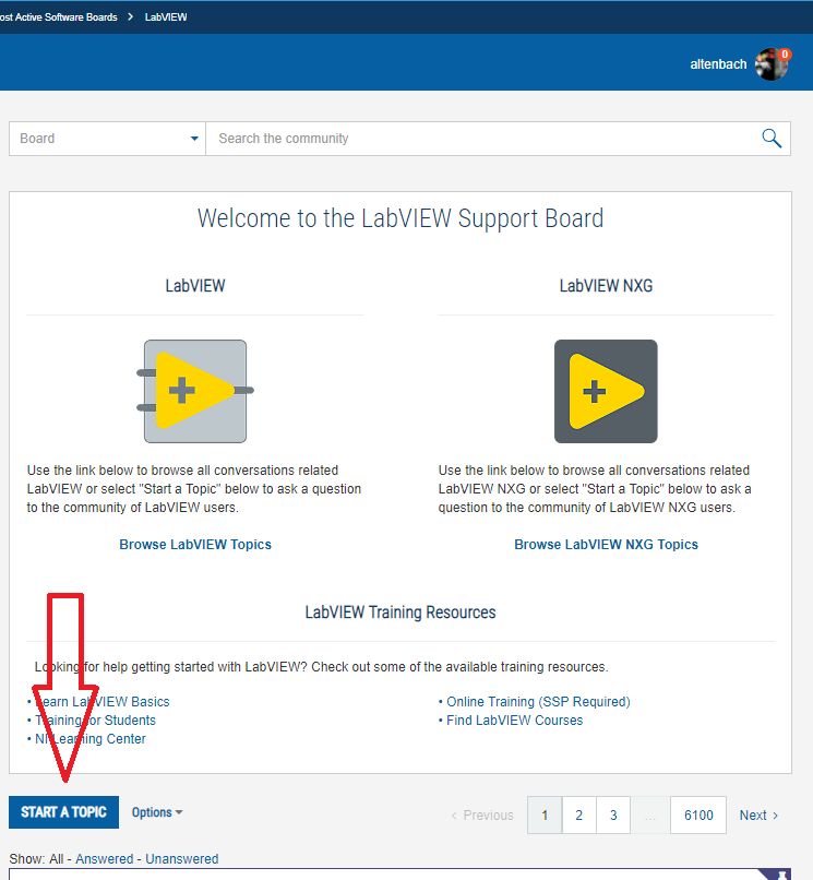

Also, I looked and looked and can't find a way to post a new thread so had to tack this on to an old thread.
(2,571 Views)
At the top of every forum page is a "START A NEW TOPIC" button.  Strangely enough, I always have trouble finding this button when I want to post a new topic.
It is called "Start a topic"

Strange way to set up forum.  Selecting a specific category such as LabVIEW or NXG for example gives pages with no new topic button.
