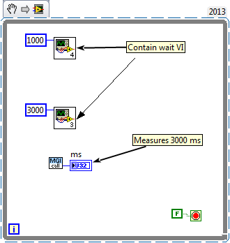

To answer your question:
LabVIEW 2013 SP1
Windows 7 64bit
Windows Server 2012 64 bit
Windows 8.1 32 bit
Message 8 of 10
(6,231 Views)
The functions will execute in parallel- the issue is that the 1000 ms wait will always take slightly longer than 1 second, whereas the DAQmx read takes any amount of time up to the timeout (one second).  Eventually (and I'd guess sooner rather than later, maybe a couple minutes or so) you reach a point where the samples are available before you attempt to read them.  Not really an issue because you're only sampling at 1HZ- the sample buffer can probably take it (hah).  As soon as we get into this scenario, the DAQmx read returns a value immediately when we call it (and updates the MGI timer) but we still have most of a second left waiting for the wait function to finish, so the next time we update the timer it will be +1 second.
Removing the wait function means that we will always be waiting/ready for a new sample to be available, rather than having one in the buffer before we attempt to read it. It looks similar, but we're sampling and updating the timer closer to when the loop exits, rather than closer to when it begins executing.
Tom L.
