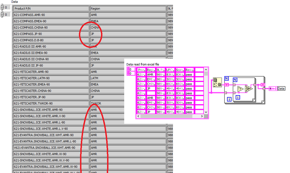

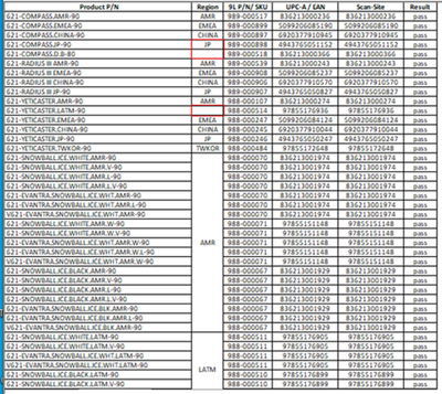

Hi all,
I read a excel file got data as below and some different with raw data in Excel sheet which merge data in sheet and read is blank by labview ,Do you have good way to handle this issue, thanks in advance!

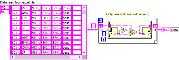

Starting from the top, you could just replace all empty fields with the entry from above. Here's one possibility:
(Of course if the merged cells only occur in one specific columns, further simplifications are possible)

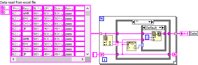

Here's how that could look like:

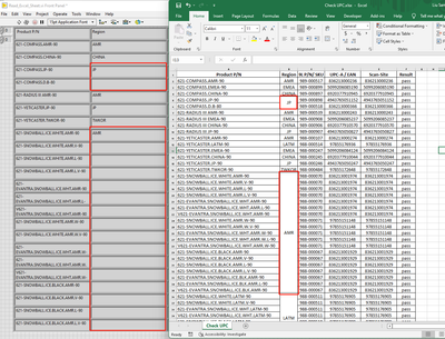

Thanks for you prompt relpy,it's very useful , occasionally real blank in excel sheet cell, how to ignore the issue, thanks!!

Not knowing about the exact format and all possibilities, it seems that it might be sufficient to substitute the previous value of the second column ONLY if that string exists in a substring of the entry in the first column.
See if this works....
