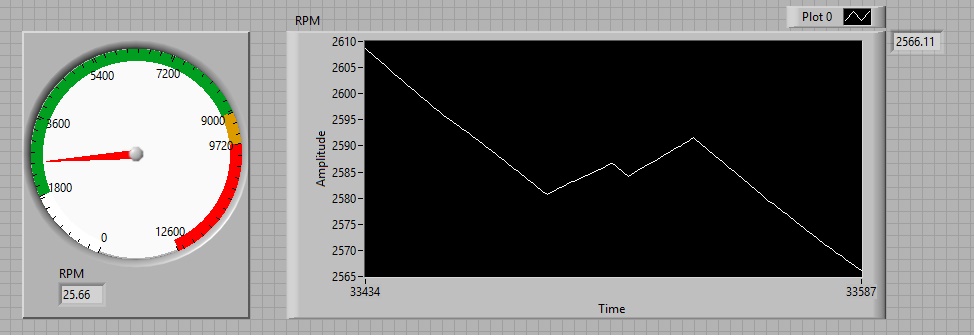

when I used this VI, the count is going up, up and up. I need when I stop, the RPM in zero condition.
so, do you have solution for me ?
Message 5 of 14
(6,419 Views)
Hi okky,
read the manual of your USB6009: it clearly says the counter can only count-up!
But what is your problem anymway: to calc RPM you need to get differences of your counter…
So when you stop your VI the last RPM value should be zero? Even when the machine is still rotating? I don't get this…
Quick&dirty: write a zero to your RPM indicator when you stop the VI…
