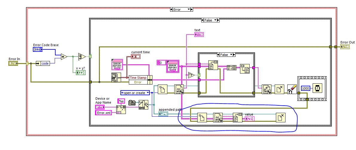

Hello, I've attached all necessary pictures and VIs/Ctrls.

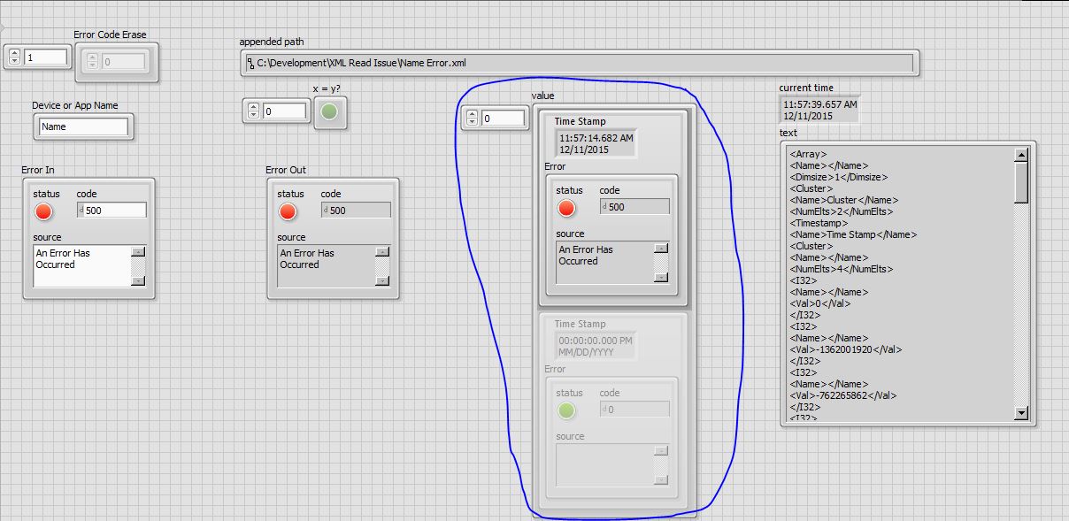

The issue: I'm trying to verify my Read/Write Text (which is writing errors in an XML format as well as a corresponding time stamp) right after I have written the error to the XML file.  What the code is doing is making sure the error is not an error I am allowing, then goes on to write the error to the XML.  There's a case structure that then handles a first time write.  The idea is to read the data back from the XML, then insert the new error into the array, and then write it back to the xml doc after flattening.  I understand the long term issues of this "solution."  So right now, please don't comment on that.  What's bugging me is that when I try to re-open and read the document, I can't seem to view ever element of the array even though the read/write function (which is doing essentially the exact same thing) can do it just fine.  I've circled the items.  The code is in 2011.  Be sure to insert text into the name for the document.  Run it a couple of times and I think you'll see what I'm driving at.  Anyone got an explanation for this?

The error itself is nothing more than an example just to trigger the error case.  Not an actual error.  The issue is the unflatten from text not producing the entire array in the circled portion.

Accepted by topic author DailyDose

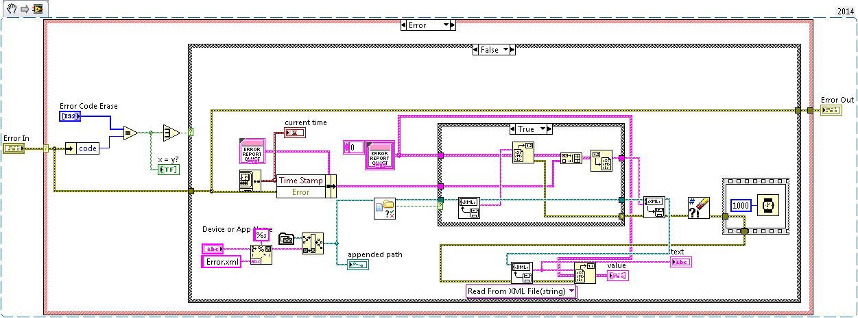

Replace your basic file open read and closes with the XML File Read and Write functions and I think it will work the way you expect.
You need to use the XML read and write file functions to serialize the data in a way that LabVIEW can reconstruct the array of clusters and timestamps.

Close the file after the first read then reopen it with operation set to "replace" before writing the updated xml string.
With a couple alterations to manage first run, your suggestion worked.  Thank you!
