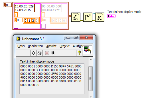

Hi esod,
see this:
I'm saving an array with just one waveform in it. The resulting file contains:
0000 0001 - array size (one waveform in the array)
0000 0000 D156 9847 5451 8000 0000 0000 - timestamp of first waveform
3FF0 0000 0000 0000 - dt value (1)
0000 0003 - array size of Y component
0000 0000 0000 0000  - first sample (0)
3FF0 0000 0000 0000 - 2nd sample (1)
4000 0000 0000 0000 - 3rd sample (2)
remaining stuff: the variant containing no attributes (?) in this example.
Timestamps use 128 bits in LabVIEW. Samples and dt use DBL datatype. Arrays have their size prepended as I32. Variant is a monster of it's own…
Forgot to mention in the first place: Those are internal representations of LabVIEW datatypes. They might change with each LabVIEW version (as happened to the timestamp long time ago), but I guess it is unlikely for the current waveform datatype…
