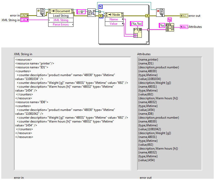

Here's a way to do it using the LabVIEW XML Parser functions.
Ben64

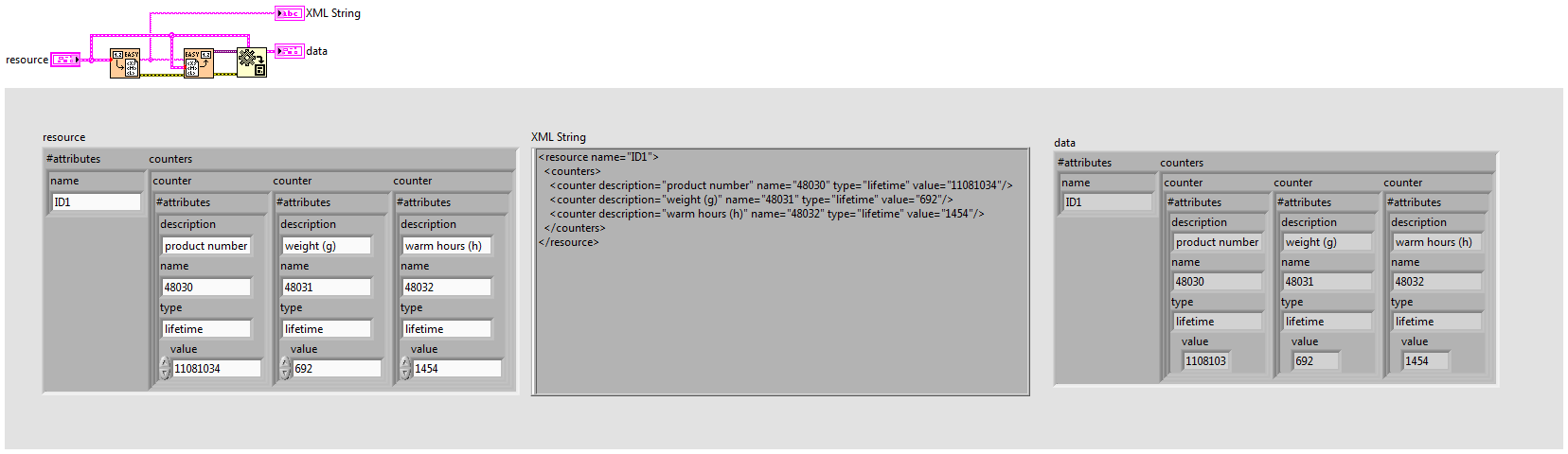

Here is how to use the JKI Easy XML functions to convert between clusters and XML strings.
Ben64

Thank you Ben, it was very helpful.
How'd you use the Easy XML to convert from XML to cluster or array of clusters for the same example?

Could you please explain why you gave //*@ as the string constant to get all matched nodes
thanks in advance
