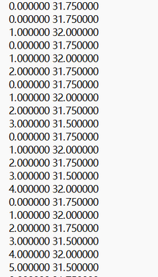

However when i check the txt file, i'm getting these weird data. It repeats the count from 0 on to actualize the new data. I just need sheet from 0 to the new data point directly.

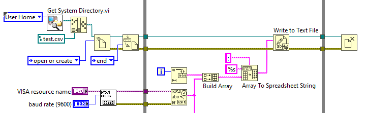

I've tried with the suggestion to put the Write To Measurement function outside of loop. But by doing so, even no files can be generated.
Could anyone help me to solve the problem?
My vi can be found in attachment.

With the feedback node, you are appending one element and then write that array to the file. You actually wanted to do this:
It should have worked when you put write to measurement file after the loop, but only after stopping the loop.
Write to measurement file is really slow. You could also write to a comma-separated text file. You can open it with excel:

Here's what I would do.
First, get away from the Write Measurement File function.  Instead, create/replace a file before the loop, close it after the loop, and you can write whatever you want inside of the loop.  In this case, you can just take the string that was just read from the Arduino straight into the Write Text File.
Secondly, get rid of the array and instead use a Chart.  The chart has a built-in history, so you don't even need the Feedback Node anymore.
