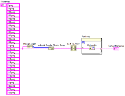

Try to scan the image number and sort by number, see
Message 3 of 8
(659 Views)

Yep, I tried this as first idea but I do not know why this Sort1darray function it is not working fine, I checked the cluster, and it records the decimal numbers fine, but the function has problems sortening a big amount of images, some of them are right some are wrong.
But thanks anyway, It was a good idea!

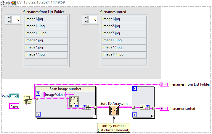

@MagneticTweezers wrote:
It is quite slow
Hi, for your specific task, you can use this code. It is the fastest of all the options offered to you and does the job perfectly.
