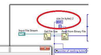

@Albert.Geven wrote:
Thanks Rolf
That fact (64 bit file pointer) helps me too.
The File IO functions support 64-bit offsets since the redesign in LabVIEW 8.0. And the according Get/Set Offset functions and similar use 64-bit integers too.
Rolf Kalbermatter  My Blog
Message 11 of 13
(1,056 Views)
Another clue was also the I64 file size in image of the OP, which turned into a coercion dot at the read function because the number of elements to read is limited to I32. 😄
These coercion dots always tell a story!
