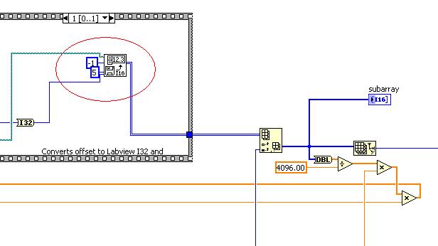

I used to use Read from I16 file.VI, but since I'm using LabView 2009, I'd like to use "Read from binary file.VI".
I've looked at the previous posting and tried the suggestions, but I still got a problem.
Could you help me to figure this out? By the way, I'm using LabView 2009 Spring (Professional version). The VI I'm trying to replace is shown below.
Jay

Jay,
Wire the datatype for Read From Binary File to 1D Array of I16 and  it should work like a champ!
Serge

In order for it to work the way you have it displayed there, you will need to wire a 2D array constant (make sure the representation is I16) to the data type input of the read from binary file.vi
Applications Engineer
