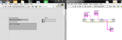

I'm trying to read data from a database and i don't know how. I downloaded the labSQL toolkit and i am using xampp (php my admin). I have made the ODBC connection and i have followed this tutorial. https://www.youtube.com/watch?v=fV14hA6GNWQ

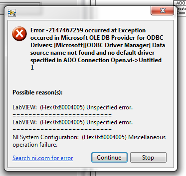

When i put together all of labsql's VI a have an error:

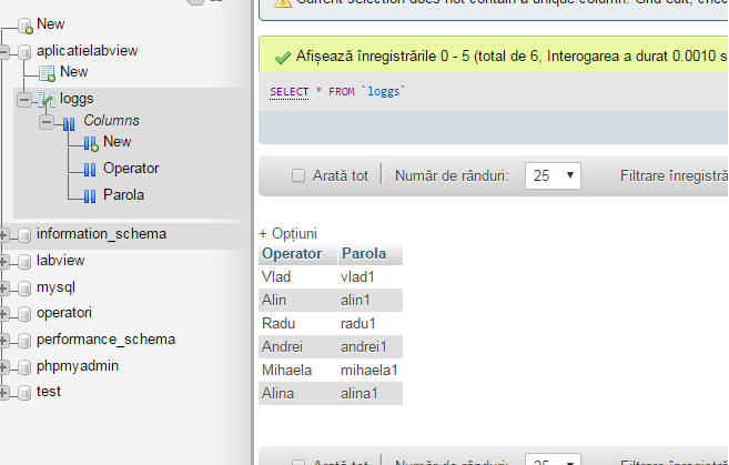

The phpadmin server:

I just want to read that table with 2 columns into labview.

You don't have a successful connection to your database.  I can't read the picture in your second post but I don't see a connection string.  Go to www.connectionstrings.com to build one for the sql server that you're using.
