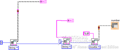

Hi, Jim@93.  Thank you for attaching two data files.  They appear to be tab-separated files (which LabVIEW calls a Delimited Spreadsheet File), but appear to lack much in the way of identifying information that would allow you to process across different files.  But I have some suggestions about how to process within a file.
First, look at the format of your two data files.  There are 4 lines of information (not sure how these would be used), a blank line, then what looks like a multi-column delimited spreadsheet with one row of Column headings and many rows of data.
Here is how I would read it, breaking it into a String Array called "Header" (consisting of the 4 rows of header information and the blank row), another String Array called Column Labels, and a 2D Dbl Array called Numeric Data.
Some notes on rarely-used features:  Read Delimited Spreadsheet, by default, reads the entire file.  In the first function, I have it read the (first) 5 lines.  I use the output, "mark after read (chars)" to tell the next Read function where to start reading ("start of read offset (chars)", and have it read 1 row of Column Labels.  I finally finish reading the File, this time as Dbls (and change the format specification to 6 decimals to match your data).
You now have a way to find the data you want to analyze.  Suppose you want to compare "R Sag Knee Angle" with "L Sag Knee Angle".  Search Column Labels for "R Sag Knee Angle", which should return 4.  You can now pull out Column 4 from Numeric Data, and pull out Column 25 (for Left Sag Knee Angle), and do whatever you need to do with them.
Bob Schor

@JimAt93 wrote:
Your answer is very detailed and I think I understand most of it but I still couldn't figure out how to create and connect to the "all rows" features the following:
1) String Array
2)2D Dbl Array
Here's how you figure it out:
  1. Put a Read Delimited Spreadsheet function on your Block Diagram (or find one already there).
  2. Right-click the function and from the Drop-down, choose "Help".
  3. Look at the Connection diagram.  Not all of the connectors are labeled, but if you read the Detailed Description, you'll find every connector described.
You should see that there are 5 (not the usual four) right-hand Indicators for the Read Delimited Spreadsheet function.  The second one is "All Rows", and the third is "First Row".  If you look closely at the Snippet in my earlier reply, you can see that the thicker (because it is a 2D array) wire from the first function ("All Rows") is higher (second position) than the thinner (1D Array) wire from the second function ("First Row").

Thanks Bob for all the replies.
First, the where to wire was not so much of the issue, you did a nice job explaining, rather how to create this abc think (String Array) to receive things. When I am taking an array and dropping the string constant in it the small black arrow is at the end of the abc. The ones below I copied them from another VI in the forum. Plus as you can see almost nothing works. Any ideas/sources on how to improve the code/my knowledge of Lab View?
Message 9 of 10
(2,905 Views)
Hi Jim,
When the "small black arrow is at the end of the abc" then you created a control. When the arrow is on the left side it denotes an indicator: the arrow indicates to DATAFLOW: controls generate data, indicators consume data…
