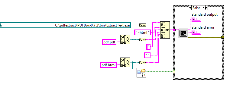

I know this is really old but here are my 2 cents.  I was having .NET issues, where I could not get the assemby to link.
Workaround... use system exec to run the executable (ExtractText in the bin folder) and create a text file from it.  Then parse the text.... worked for me.

This is the area of interest.  Basically in the extract PDF mentioned earlier there is an actual EXE rather than the .NET stuff.  So run that exectuable with the -html in the command and it will create a html file for you.  I then opened that HTML file and parsed it as I needed.

Hello Evan
I am trying read txt from a pdf using the explanation and block diagram you posted. However I saw error messages in my "standard error" indicator as opposed to seeing converted pdf-txt contents in my "standard output" indicator :(. Please could let me know what I may be doing wrong?
