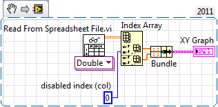

Try this:
CLA CTAChampionI'm attending the GLA Summit!

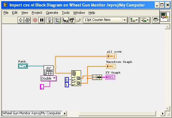

Not sure you can with a waveform graph - you can with an XY chart though.

Hi Thanks,
I would like to build waveform with the values, attached the Vi.
With XY graph I am getting the right X-Axis value( 2nd graph) but with build waveform the X-axis is not right(1st graph).
Any suggestions.

Smiler123 solution is correct, I am trying to do in Build waveform rather than XY graph.
