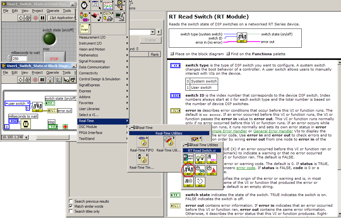

Has anyone an example of how to read the configuration switches from the cRIO-90xx controllers. I want to read the status of the USER1 setting but haven't been able to find an example or a way to achieve this.

You need to use the RT Read Switch.vi, located on the RT utilities palette. (See screen shot).
Note: You can only read the switch from the RT target, I attach an example RT VI in LV 8.2.1 format.

Exactly what I was looking for, I know I'd seen how to do this somewhere....
Thanks for the nicely detailed response
