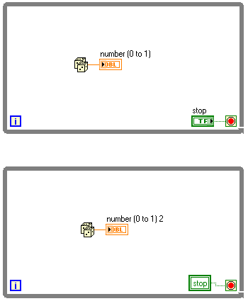

And another question. Is there a graceful way to get all my loops to shut down when a stop button is pressed? Or is the answer just "Stop using all those parallel loops and you won't have that problem"
HI IMSargon,
The easiest way to stop multiple loops is to use one Stop control button and then create local variables from that control and have those wired to the other loop conditional terminals. You will have to change the mechanical action of the Stop button in order for this to work. I recommend Switch When Released. Here is a simple example:
Hope this helps!

@ Aaron P
D'Oh. I was sure I had tried that. Thanks for the tip.
