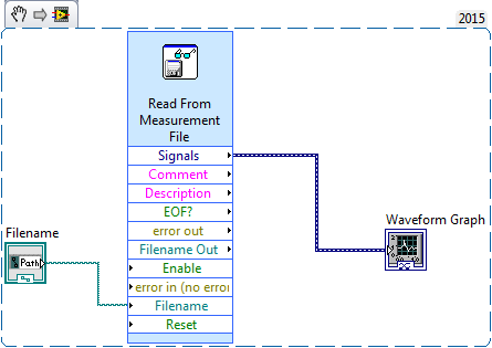

This is OP's code. Simple.
What approval are you looking for here. Look up some examples of how to read from measurement files and/or how to graph data and you'll be fine.
Here's the help file related to your express VI. At the bottom it lists a couple of examples to check out.

Does Read from measurement file work with xlsx data in LV 2015?
It is packed format, it is not text xls file.
Message 6 of 9
(7,030 Views)
Oh yeah, good point. You can't read an xlxs file just like this. You need to either use the Report Generation Toolkit or an third party add-on.
Excel file IS NOT EQUAL TO spreadsheet measurement file.
Save the excel file as a CSV or some spreadsheet format so that it looks like a plain table and then read that in.
Cheers

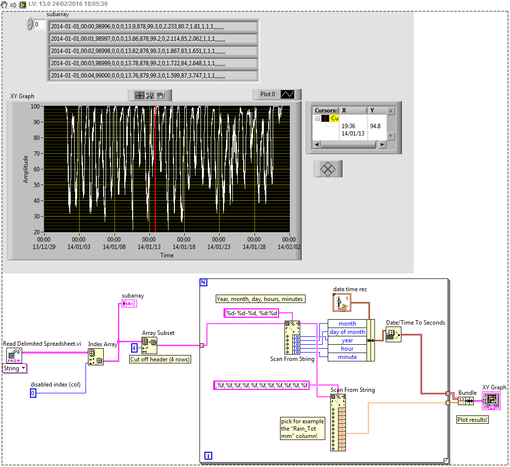

@Sylv01 wrote:
I am using LabView 2015 version. again here what I have done the attached documents, I know have to read discussion forums but sometimes I found out it not exactly similar case as the one Im facing. I have such huge Data for solar station on excell now I read it on LabView as in graph format, I need help or an approval on the result I got since I hardly know LabView. Thank you!
What you try to do, does not make too much sense. You cannot use a "Read From Measurement File" Express VI to read a native Excel file. Moreover, what is the data you would like to plot? I can see at least 11 data columns in this Excel file, which could be as Y-values beside the time stamp columns (date and time).
You need to use ActiveX in order to read native Excel files. Also, I think the "Report generation toolkit" can do this, if you have it:
https://forums.ni.com/t5/Example-Code/Reading-Excel-Data-Programmatically-Using-the-Report-Generatio...
Other option is to convert the xlsx file to comma separated text file (csv) using Excel (save as csv (DOS) file), and then read it with File functions in LV. After you got all the lines as string, you have to parse out the info you need. You have to convert the time stamps to LabVIEW time stamps, and other numerical data to double data types. After all these, you can graph what you want...
Message 8 of 9
(7,006 Views)
Here is a snippet, you save it and drag&drop it into your block diagram. I also advise you to learn some LV from the available tutorials, see details on the top right corner of this forum!
(do not forget to convert the xlsx file into csv using Excel)
Message 9 of 9
