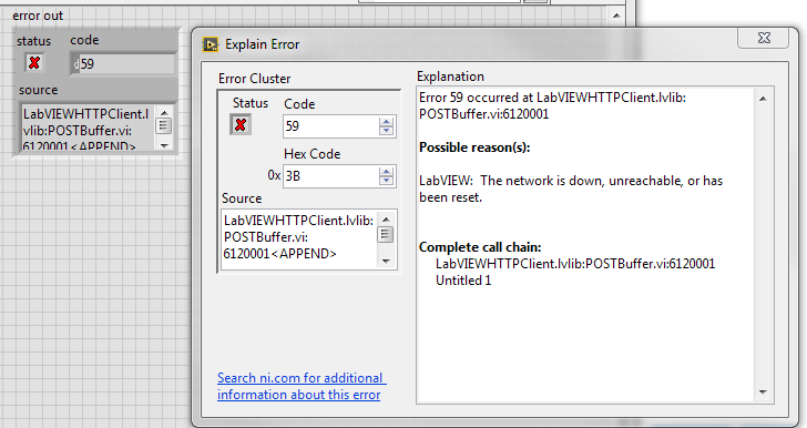

Is there an error message that comes with it? Normally you get more information than just the code and the error source which would indicate the reason for the error. These are basic steps for troubleshooting issues with your LabVIEW code.
Right click on the error indicator and select 'explain error':

The problem seems the certificate, this error:
LabVIEW:  The certificate path or CA information of the local host is invalid.
In CONFIG SSL function should I put both certificates ( CA and CLIENT ) or one is sufficient ? which? and where is it ?
