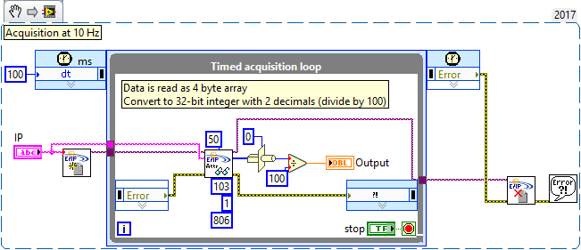

Thanks for the reply. I managed in the end. There are two ways of communication to this unit: cyclic and message communication (explicit).
The Instance ID 100 referred to before is for cyclic messaging. After consulting with Keyence this seems to be only possible with an actual PLC to configure the messaging intervals etc.
With the *right* manual, we found that Attribute 804 for Message Communication contains the raw value. Reading Class 103, ID 1 (first sensor), Attribute 806, and doing the proper conversion, then gave us the raw output. See the Snippet below.
(Note for future users: the actual Attribute depends on which sensor type is used.)

Sure. What is it you want to know?
The readout is pretty straight-forward; a timed loop that reads an attribute. The code also works for the NU-EP1 that we have. Just change the Class/Instance/Attribute to read.
Refer to the specific manuals for that, also minding the sensor type connected.

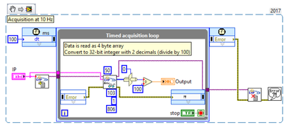

Thanks for your reply.
Could I use this Snippet to connect Nu-EP1 with computer as long as I change the Class/Instance/Attribute ID number.

Indeed, it should work like that. Just set the right IP address, and Class/Instance/Attribute IDs.
Also double-check the manual for the output data type. For the NU-EP1 it is 16-bit I believe, for the DL-EP1 usually 32-bit. Change the '0'-value in the snippet to 16- or 32-bit representation for correct conversion.
Same for the division after; the DL-EP1 has two decimals (hence division by 100), the NU-EP1 has no decimal position, so no division necessary. Though this may differ per Mode of the device.

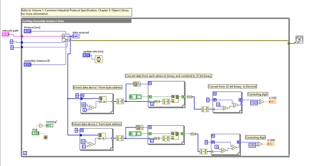

This is work. Read data from Keyence DL-EP1 is unsigned 32 bit data.
Device 1 @ byte address 48-51,
Device 2 @ byte address 52-55,
Device 15 @ byte address 104-107.
I read data from each byte address of each device then convert binary.
Then combined to 32-bit binary.
finally, convert 32-bit binary to decimal.
Message 10 of 10
