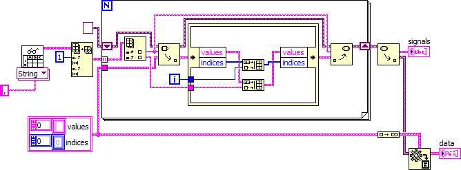

 Munna,
how do you decide it is the very last message "A", when the last signal value is received in row 9993 and file itself only has 10033 rows?
Additionally "A" has intervals between ~20 and ~80 rows, so in my opinion I would guess "A" is still alive for the rest of the file!
When you don't know anything else about those signals it seems you need to scan twice…
I used this one to scan your files:
Message 24 of 25
(1,839 Views)
