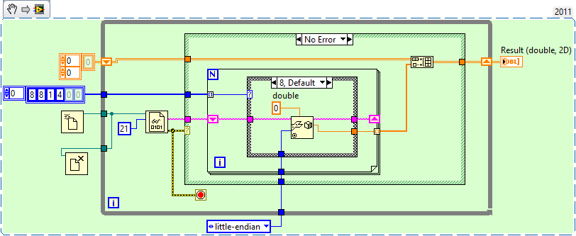

I think GerdW already sketched a solution, here is my version:
This example uses a pattern 8,8,4,1 as an example. You should care about data interpretation. For example, 4 can be a floating point SGL (as in my example) or a signed integer I32 or an unsigned integer U32.

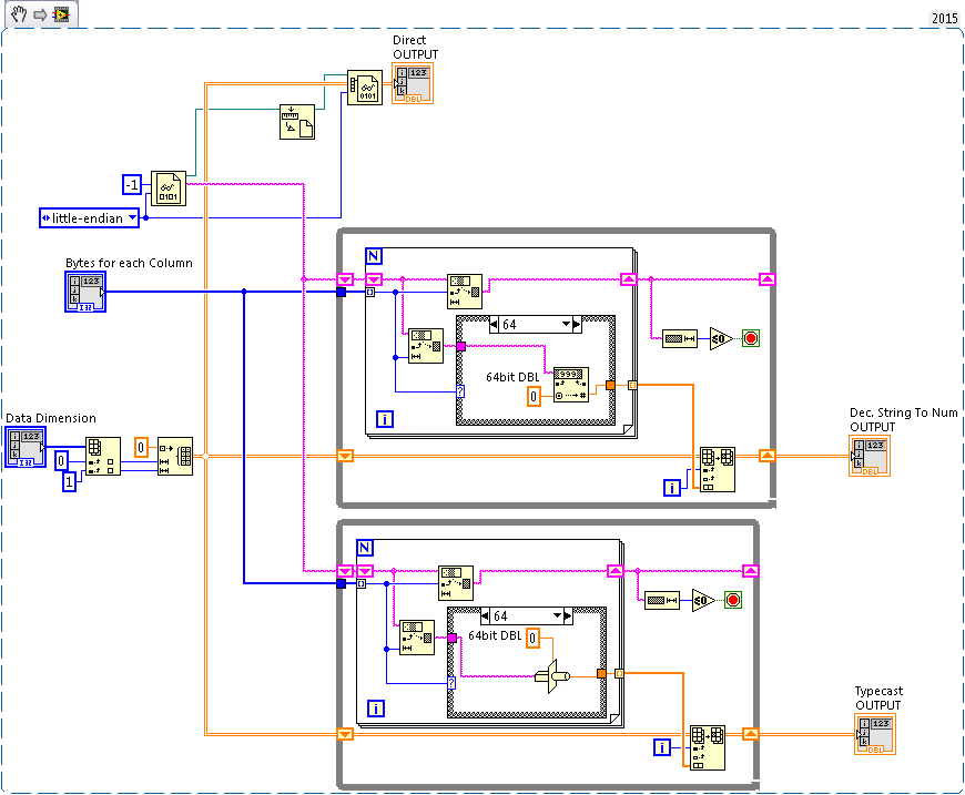

@pincpanther: Your solution is similar to my previous post, however that still gives me back incorrect values... I have now tried out your exact program (and even replaced the "deserialise string vi" with a typecast) without luck. The output I get from this routine are whole integers (represented ad DBLs) throughout the array...

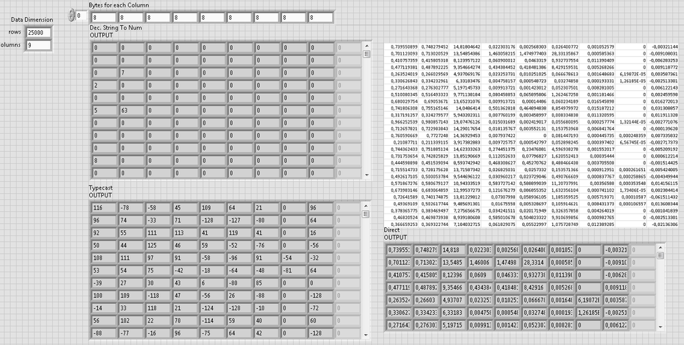

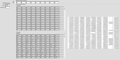

I've attached the data file again (1.7Mb, zipped because of .bin extension) and also an updated version of the previous pictures in which I now also use the 'Preallocated Read from Binary File' vi, which works great!

Hi Doug,
you defined this "Bytes for each column" as an array of 9× the value "8".
In the conversion routine you convert an item of "8 bytes" into an U8 value - why do you wonder you get just U8 values???
You should rename your "bytes for each column" into "bits for each column" and input "64" instead of "8"…
Message 16 of 21
(2,241 Views)
I can't follow you...
That array only holds the number of ASCII characters to be read from the string. Its datatype should be irrelevant! An '8' in that array only means "read 8 characters (aka a 64bit DBL) from the string". I've just tried out changing the datatype of that array and it has no impact on the program (as it should be, since the 'String Subset' vi expects an INT anyway)
Message 17 of 21
(2,236 Views)
Hi Doug,
but your case structure is expecting a value of "64" to call the case for DBL conversion!
A value of "8" calls the U8 case!
There is a reason why often ENUMs are suggested to be used with case structures…
Thank you! That was indeed one issue. That is now fixed, but I am still getting wrong numbers (but at least they look like floats now, albeit with very large exponents...)

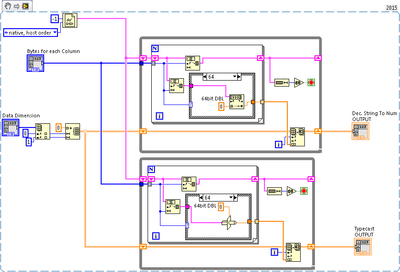

Hi Doug,
as has been said before: use UnflattenFromString instead of TypeCast.
Use the "little endian" option…
