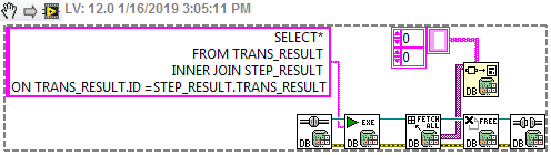

so I tried it , this is what happened refer attached , any thoughts ?

That's how a join works.  It's trying to combine every single row in one table with every single row in the the other table where the two ID's are equal.  When you run this in Access, it is able to display it in a grouped view so that the duplicate data is filtered, rather than showing all of the data as you are seeing in LabVIEW.
