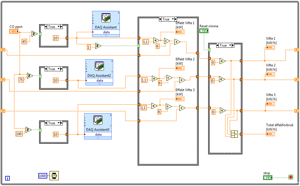

We are some students working on a schoolproject where we want to control some motor outputs. We want to create a set of input-values that are being red into our program either excel or text file.
For example we want a input to read value "1" then the program runs its course and we get a result of the input "1", after that read the next value "2" and the program runs its course and so on.
We have searched for clues and answeres, but i guess were really bad at that. Anyone here that could help us out?
Under you can see one of our programs, its designed to control 3 fans depending on the input (CO ppm). We want to replace the "Numeric Controller" (CO ppm) into "something else" that gives us one and one input from a list of values.

We have managed to create the file to read from and getting the output shown below.
But our new problem is implementing it to our VI as shown below
Have checket the forums for conversions to numeric, but we still get some errors that faults our comparison function.
Any suggestions?

None of that makes any sense. First, you not want to be constantly reading the file in a loop. Second, off you want the values as strings, simply select that type by clicking on the polymorphic selector below the function. There doesn't appear to be any need to convert to strings, however. Third, if you want to compare each element to some value and connect to a case statement, the read from spreadsheet should be outside an auto-indexing for loop with the compare and case statement inside the loop. You simply cannot connect a case selector to an array.

To simplify our questin of what we want is to switch out our input (CO ppm) to a function that reads a set of values. Say that it first read "20" then "45" --> "60" --> "75" --> "90" -->"100" -->"100" --> "90" and downwards in timed intervals.
The different values that are given in will be compared to different set-points, when the comparison values are met, we get an output depending on how many compares are triggered.

So do as I recommended with the Read From Spreadsheet outside a for loop. If you are unaware of a for loop's auto-indexing feature, you really need to take some of the free LabVIEW tutorials.
