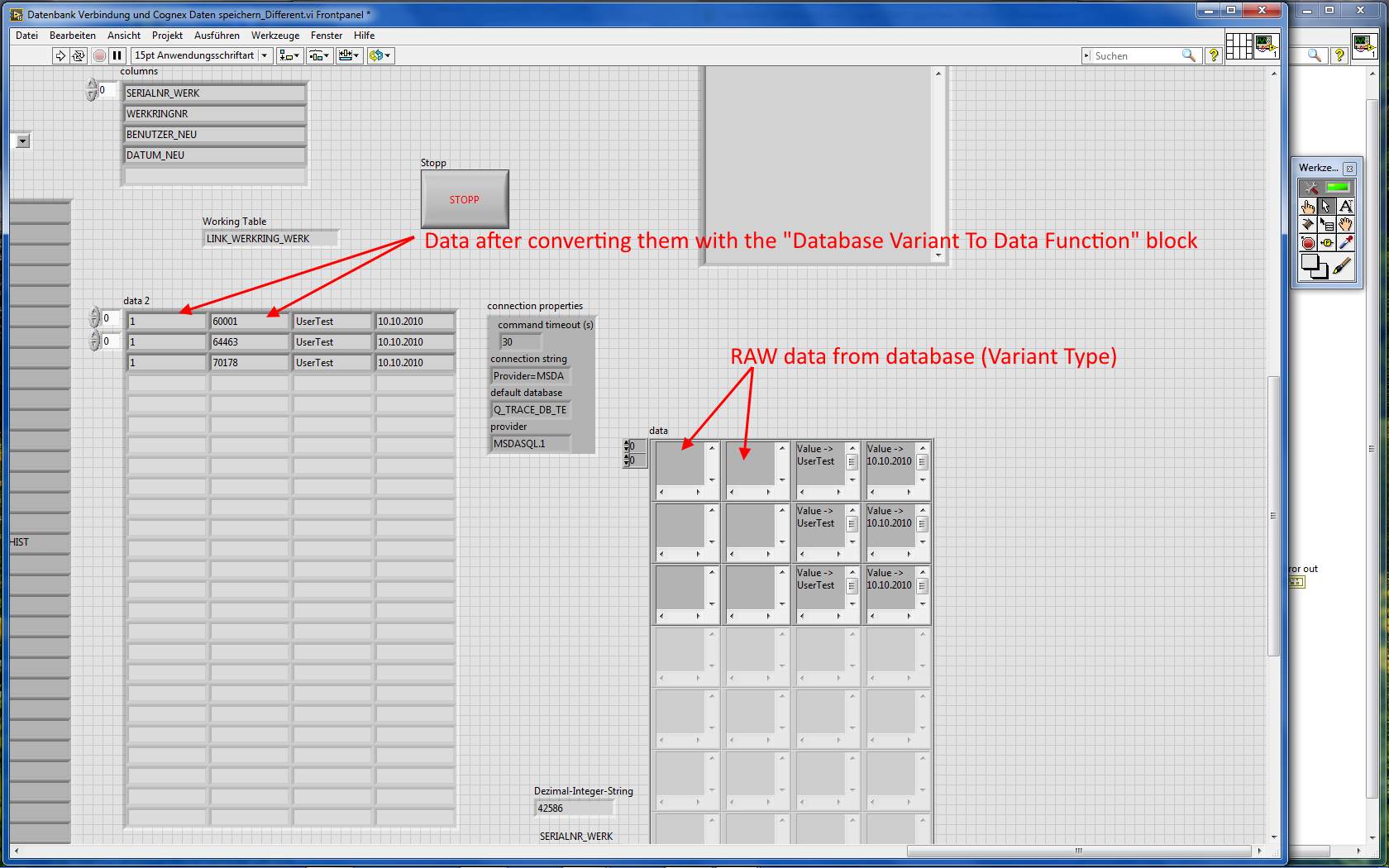

By using the "Database Variant To Data Function" ( http://zone.ni.com/reference/en-XX/help/370016E-01/lvdatabase/database_variant_to_data/ )from the database toolkit, I actually managed to display my data correctly. (see next picture)
The problem looks like to be in the output data from my database which is given to me after using the SELECT function.. I have to convert it to make my numbers (the first two item of the sent cluster)  displayable (but the date and the varchar can be directly displayed)

But still, it looks like the data were correctly written since they're displayable after this "Variant To Data Function"..
Now I'm just wondering if I could skip this step or if it's definetly necessary !

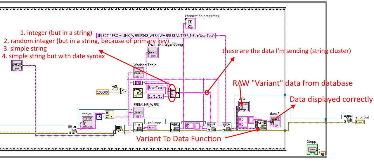

And by the way, the first two columns in my database table are DECIMAL(20,0), so I first tried to send them as simple integers (on labview) in my cluster.. like this
but it didn't change anything..
