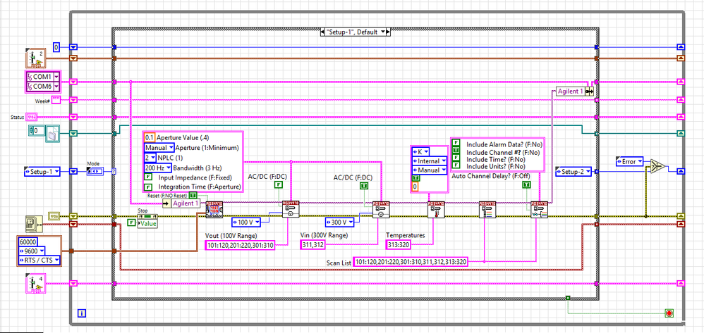

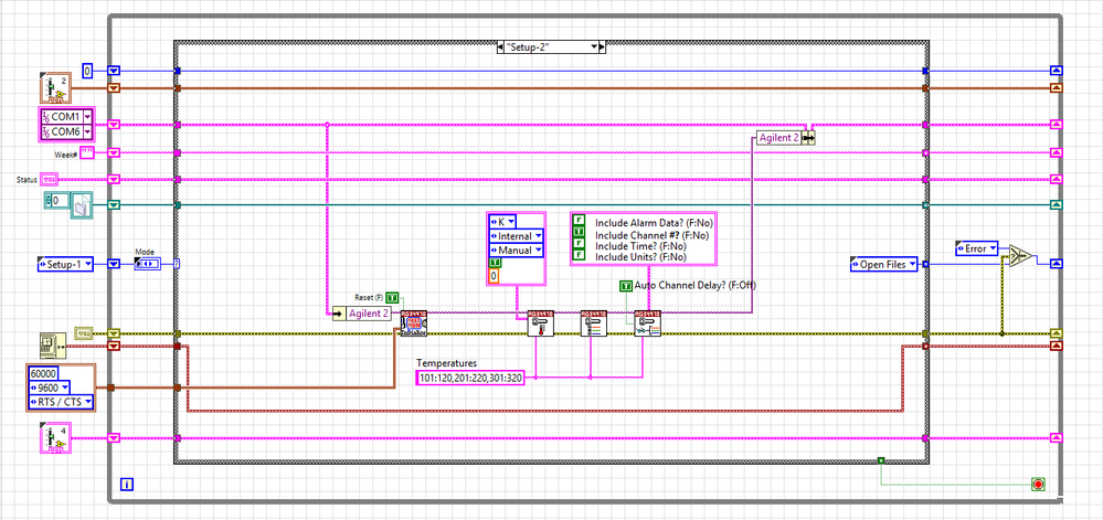

Here's an example of how to properly use this device. This program was an Accelerated Lifecycle Test that used TWO FULLY LOADED 34790A's to monitor temperatures, and output voltages for must have been 30 individual units under test.
34970A #1
  1. Initialize 34970A
  2. Configure DC voltage measurements
  3. Configure AC voltage measurements
  4. Configure K type thermocouples
  5. Configure Scan list
  6. Configure Scan
23970A #2
  2. Configure 60 K type thermocouples
  3. Configure Scan List
  4. Configure Scan

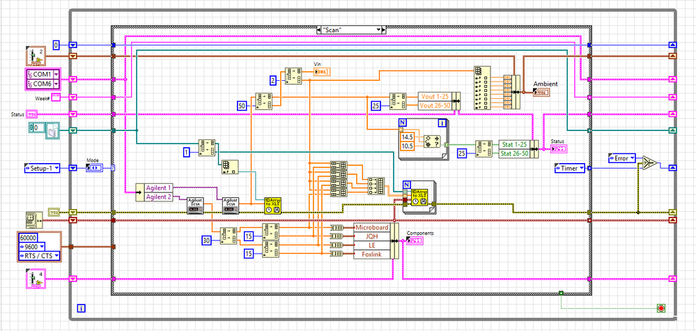

Now this one looks complicated, but it's not really. This is where I take measurements Sort, display, and save them to a file. SO most of the mess is sorting things for display. Follow the Error Cluster for the important parts that I will touch on.
  1. Take a measurement (Scan 34970A's)
    1. I wrote my own "Agilent Scan.vi" years ago to make it more user friendly. My vi outputs data in three forms. Numeric Array, String Array, and a "CSV string". Long ago I found that helpful, but honestly I onlt ever use the Numeric Array output anymore.
    2. I will attach this VI for you.
  2. Write data to file (1D Array to XLS)
    1. Now this vi of mine is very handy. It takes an array of numerics add a time stamp, and writes them to a text file that can be opened by Excel.
    2. I will attach this vi too
  3. The rest of this diagram is sorting measurements for display and writing to four other files
