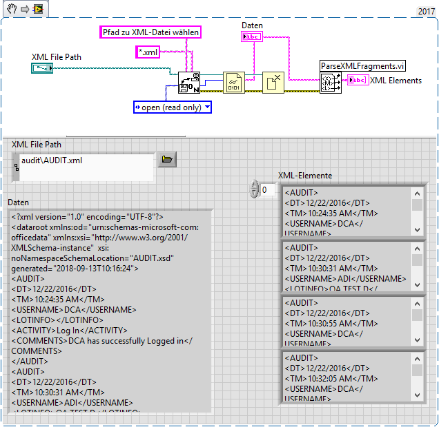

 although "parse XML fragments.vi" does take some amount of time to execute,
  using "parse XML fragments" on "audit.xml" from the zip-file results in the following:

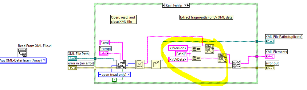

Place Read From XML file.vi on BD and open it. You'll find how it works.
ParseXML fragments.vi is part of BD, I've taken it from here, not from menu.
My image is snippet, so you can save it and drag on your BD.
