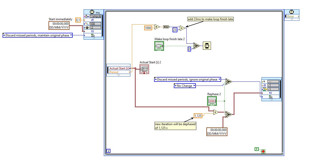

If I understand you correctly what I could have done it set a new phase and, at the same time a new mode (the way the timed loop behaves when it runs late) using the right node. Here is what I tried:

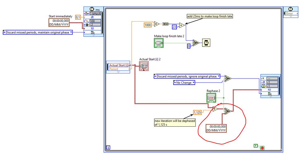

This does a good to set the new phase however, the way the loop behaves when it finishes late is also modified. Here I want the loop to discard the missed loop and keep the phase but it can't use this mode anymore:
- If I set the mode of the loop to "maintain original phase", the loop ignores the new, dynamically modified, phase and go back to the original phase (the one the loop had when it started for the first time).
 If I set the mode of the loop to "ignore original phase", the loop uses the new phase but if it runs late the phase is modified.
Am I missing something?

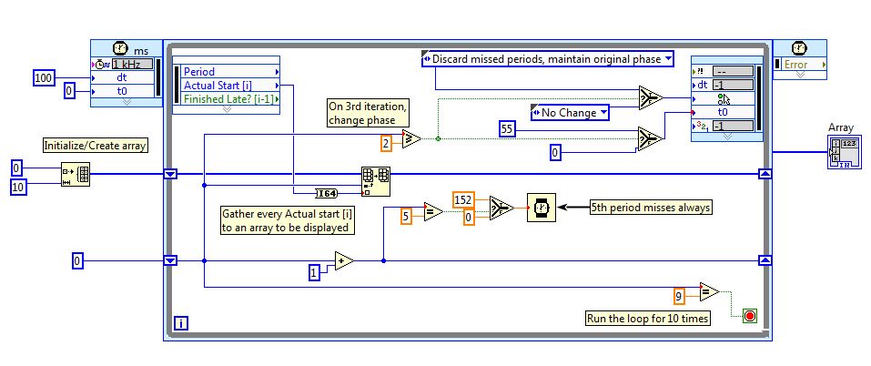

Hi Peper,
I'm sorry it took me a while to answer you back, but I wanted to make my own example program (based on your design, with a few modifications) just to be 100% sure that my information is correct. You are right! Setting the mode for "Ignore original phase" will set the loop out of sync indeed!
However...
The mode setting "Discard missed periods, maintain original phase" should have exactly the functionality you are looking for. It doesn't go back to the "original" phase, but should keep using the "new" phase instead.
Take a look at the this VI and the corresponding results. The VI always changes phase on the 3rd iteration of the loop. Then it runs 2 iterations with the new phase, after which a loop is missed because it runs late. From there on, it runs normally with the "new" phase. I will attach it so you can freely edit it and compare it to your own program (it should run on a cRIO target).
And the results:
What I suspect is happening in your VI is this:
When the button is pushed to set the "new phase" it will run the phase for one iteration, after which the buttons value returns to false. After this, the select node selects the "original" phase again for the following iterations.

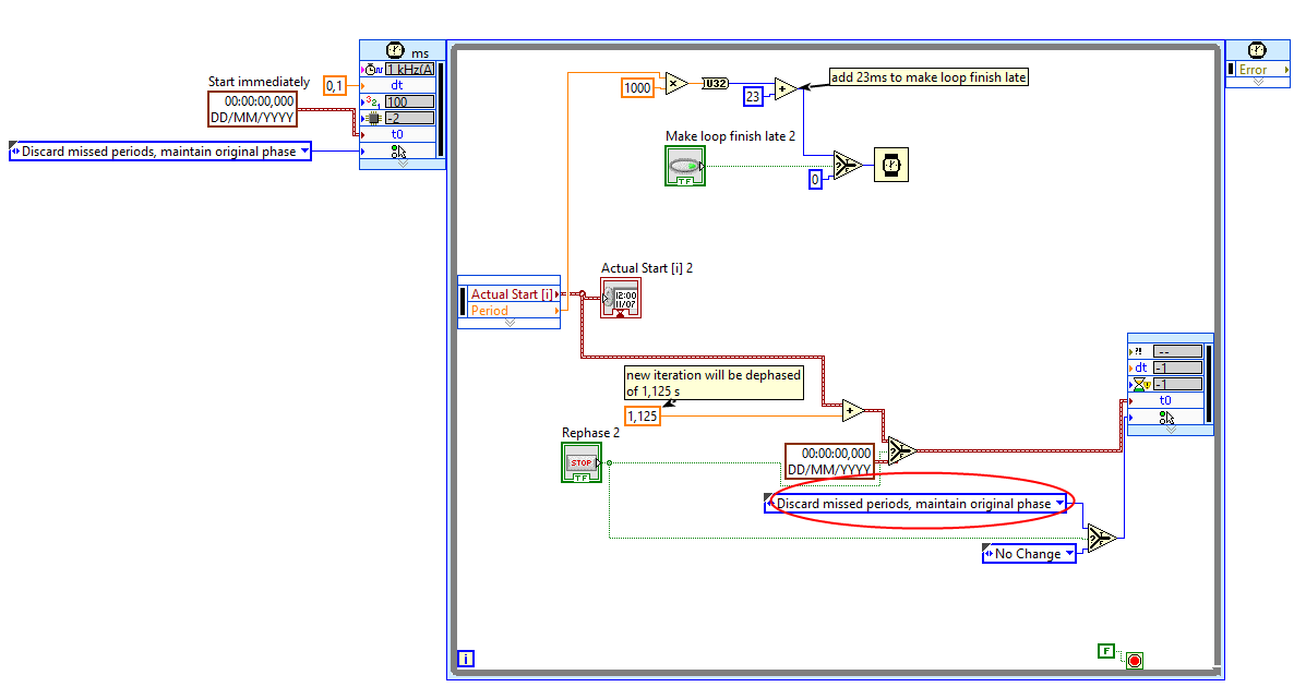

I think the behavior of the right inner node is to take the new offset into account only if the mode is different than "no change" (as explained in the Labview help by the way).
My mistake was that I set the mode to "discard missed periods, ignore original phase", if I set  to "maintain original phase" it works as expected. And hence "original phase" must be interpreted as the phase of the loop the last time the mode was different than "no change".
In summary, this works:):Labview Rephase 3.png
Thanks for your help,
peper
