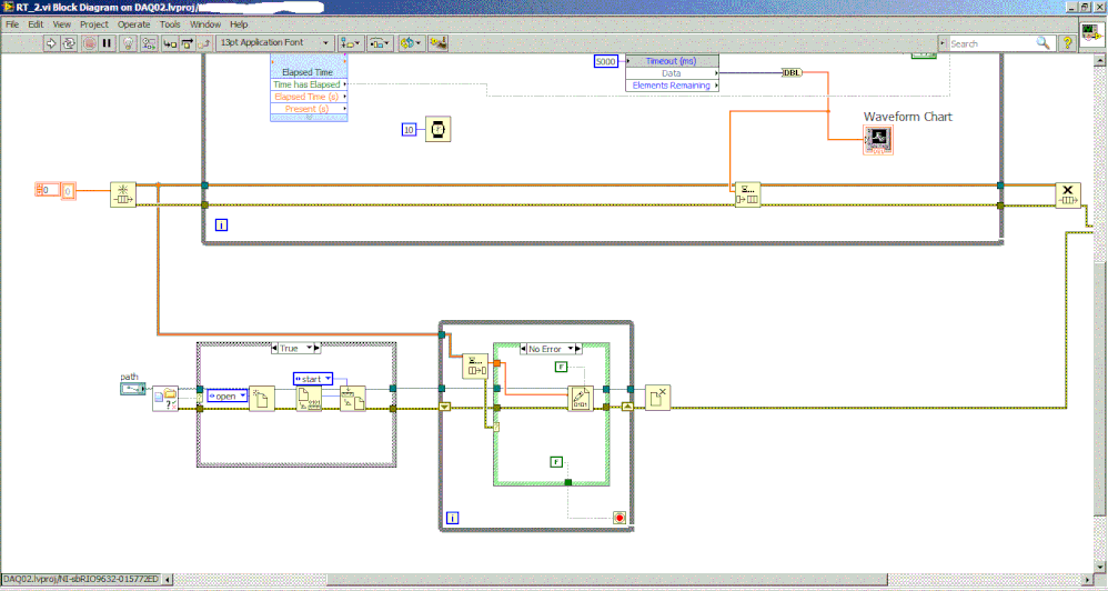

Here are my thoughts. At 2kHz rate, it would be better not to use an express VI to do file I/O operations (in this case the write to measurement file.vi). Use the lower-level VIs instead (like Write to binary file, write to text file etc.). Also, you might want to put the file I/O operations in a separate while loop. This is so that the file I/O operations does not slow down the loop where the program displays the reading on a graph.
For the file I/O operations, take a look at the example given in LabVIEW. You may want to try looking at binary file type, instead of text file. Text files takes up more space compared to binary file type. So if you are looking to log data and save to the local drive on the cRIO for extended period of time, you may run out of space pretty quickly if you use text file type. The example is called simple binary file.lvproj. Use the example finder to look for this project.
As for separating the File I/O operations in another while loop, you may want to consider using queues. This a method to pass data between to parallel loops asynchronously. Take a look at producer/consumer design pattern from the link below:
https://www.ni.com/en/support/documentation/supplemental/21/producer-consumer-architecture-in-labvie...
An easy start is to take a look at the simple queue.vi from the example finder.
A snippet of the modified RT code would look something like this:
You will notice that I combined queues and the file I/O VIs. Take note that you will need to modify your code based on the examples that I have given you, so I suggest that you try out both examples first in separate VIs. Make sure both codes work properly before you intergrate to the main code. Hope you find this useful. Happy coding.
