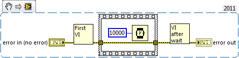

The sequence structures might also be confusing when your wait actually happens. I would suggest moving your wait to between two VI's like this.
