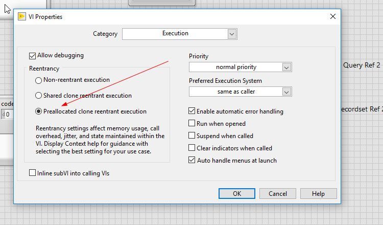

Bob Schor explained the difference between parallel and asynchronous calls earlier; I think you want to make sure your VIs are configured to run in parallel.
Right click the the VI icon and select VI properties, choose the Execution Category and check preallocated clone. Make sure all your VIs and the VIs contained within have this option if you want to do parallel execution.

when I was initially reading into this, I found the link on asynchronous calls for parallel execution within the kb on reentrancy... and I guess I followed it down a rabbit hole.  All I really needed to do was make every subvi of the subvis reentrant and now I'm down to a total query execution of just over 1s.  which is within range of my target.
Thanks for pointing me back in the right direction... doh!
