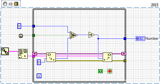

Hello
I know this discussion is pretty old but i am in the same situation as meg57 (existing application with FGVs AEs which i need to make multi-instances) except that it's a Windows application, not RT.
I was really interested by the VIT solution but unfortunately it doesn't work when i build an executable, it throws an error 1127 Smiley Sad
After reading several other discussions here and on the LAVA forum, I finally have the idea to encapsulate the data of my AEs in variant attributes (1 attribute per application instance) and use "Call Chain" to identify the instance. See below this idea applied to the example FGV from GregFreeman.
Can someone give me a feedback on this solution ?
Yohann L.

We have used the variant attributes in AEs with great success. Generally we prefer to use classes but we have some cases where we do not really pass wires for some items and they make use of a FG which stores each instance of the relevant data in a variant attribute list. The caller simply passes in their ID and are provided with their data. The concept would work in an AE equally as well.
Mark Yedinak
Certified LabVIEW Architect
LabVIEW Champion
