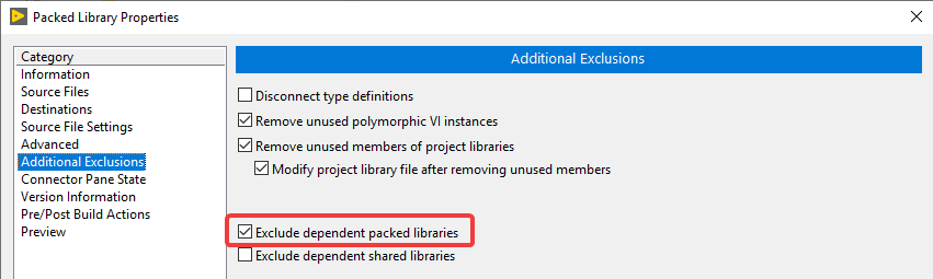

How would you go about referencing a PL inside another PL without creating a copy of the referenced PL when building?
I have a PL1 that is used by PL2. PL2 is used directly and so is PL1 so when LV builds an executable I assume PL1 gets included twice even though (in this instance) they are the same version.
Found the solution for this part:
