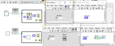

You can insert any panel in a subpanel. If the VI isn't reentrant, you can use a static VI reference to insert it's panel in a subpanel. Then, you can use the sub VI as a normal subVI (e.g. without a UI loop). Alternatively (or in combination) The VI can return it's control references, and you can use those to update the panel.
If the VI is reentrant, you can still put a known number of instances on the diagram. Each VI returns it's reference, you can put in a subpanel, and use Call By Reference to update it.

You should be able to use a (static) VI reference, put the panel in a subpanel, and use Call By Reference.
You probably make a VI with a loop, and put it in a subpanel. Then, running it isn't possible, because it is already running. (Again this is the same for any VI, in a class or not).
You have to choose:
1) Make a VI that runs, and send messages to it.
2) Make a VI that doesn't run, so you can call it to update. Either by reference or not.
EDIT: 3rd way:
(5,238 Views)

My understanding is that the Property of the VI Reference in each of you examples would be 'Running'. And this means that I cannot Invoke Run VI on them.
I can see how your examples catch the ways I have been calling the relevant VIs, particularly the second! This works fine, but it seems a little clunky to me to use the This VI Reference on the connector pane. I would like there to be a call inserted VI method, I wonder is there an underlying, computer science reason why this would be bad?
Not for the 2nd. Run VI would work.
Keep in mind that Run VI does need an idle root loop. So if the user activates a menu, the Run VI will wait for the menu to go way.
I'm not sure why that's clunky.
In general, I'd advice to make VIs put themselves in the subpanel. But I'd also always put the VI in a class. Then the VI returns it's class, with the VI reference and control references set.
