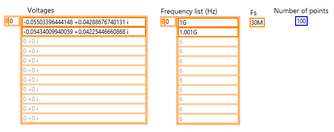

I am trying to compare waveform of two-tone signals that being generated ( form RFSG & RFSA) with the oscilloscope. I am unable to regenerate a signal having all the information such as, amplitude (in voltage) , freq. and phase to be compared with oscilloscope. The vi contains all the data are needed with the photo of the scope for the generated two tone. Thanks in advance

I am not sure how to interpret the data in your vi:
I understood that your voltage array contains the definition of two waves ("tones") in complex number representation. Using math, I find that the first one has a max. amplitude of ~0.069771 and a phase at index 0 of 37.93°. The second wave is ~0.068835 and 37.87°.
Note: amplitude = sqrt((-0.055...^2)+(0.042...^2)); phase = arctan(-0.55.../0.042...)
I interpreted 1G and 1.001G as the frequency of the both waves. I then assumed that you added both waves to get the one shown in your jpg. So far this seems to be close to correct, as the maximum shown in the jpg fits the sum of the two waves' amplitudes.
Fs would be a sampling frequency. However, as 30E6 is much smaller than 1E9, I have no idea what this value is meant for.
When creating two waveform with the values I derived from you VI, then adding these, my result looks different from what you expect. Mainly because the difference in frequency is so low (1E9 vs. 1.001E9) that the shift does not happen as fast as seen in your jpg.
Edit: Attached my vi, just in case this was about how to create the code.

Hi Kaiser,
Thanks for your feedback, yeah, all the information that you mentioned for interpreting my data is right. I have added the sampling rate just for clarity.

Actually, I do not  understand how the the small shift in frequency (1 GHz vs. 1.001GHz) given in numbers shall fit the image (scope.jpg) you posted. In there, I see three peaks (@ 2.95E-8s, 3.06E-8s, and 3.35E-8s) that seem to be the superposition of the waves. These are almost consecutive, there is almost no change in width and height, so the two waves seem to be mostly in sync here. However, there is one double-peak in the middle, that clearly shows two peaks that far apart that they are almost to single peaks instead of one superpositioned (@ 3.15E-8 to 3.25E-8). I have the feeling I am missing some information here.
