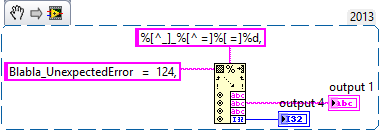

hi Blokk,
if using scan from sring --  %[^_]_%s =%d
bp
Message 3 of 9
(5,953 Views)
This works too, but it's more difficult to make it fit your exact needs, it's less flexible. You do get an integer, instead of a string.
Message 4 of 9
(5,952 Views)
