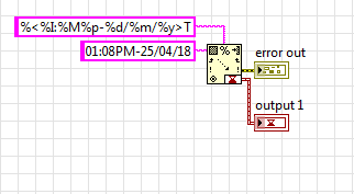

Using LV2015 SP1, I'm trying to convert a string to timestamp using Scan From String VI. The input string is like: "01:08PM-25/04/18" and the format string is: "%<%I:%M%p-%d/%m/%y>T". The conversion works just fine on my PC with English settings in Canada, but produces an error (Scan from String (arg1)) on a client's machine in Mexico. Digging deeper, I found this in LabVIEW help about the format specifier:
Format Specifier Syntax
%T specifies absolute time. Any information you include with the < and > brackets indicates how you want to format the absolute time. This format, including the punctuation, changes based on the regional settings of the computer.
It does not give any further explanation as how it changes. I am explicitly setting the format specifier and the input matches the specifier. Not sure which part is left to the computer's regional settings, and not sure how we can fix it so it works on every system regardless of the regional settings.
Any help would be really appreciated.
Soheyl

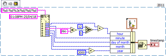

Hi Sohey4,
How can I create timestamp from string bits without … encountering the same problem?
The "hard" way:
I don't care about those subtle annoyances of the AM/PM marker with time (like 12:01AM = 00:01 in 24h format), that would be up to you…
One problem always comes from using years with only two digits like in your case: the "standard" behaviour usually expects 4 digits!
