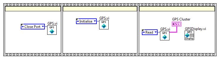

Top Level tester VI - GPS.vi runs and fills GPS cluster

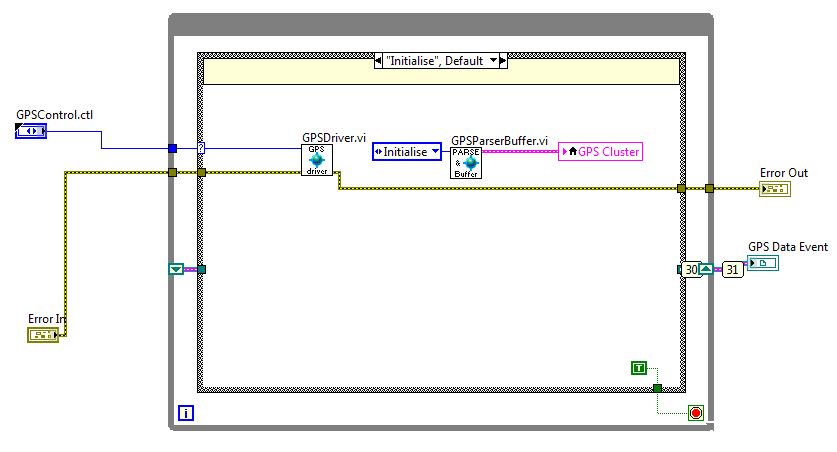

GPS.vi initialise case

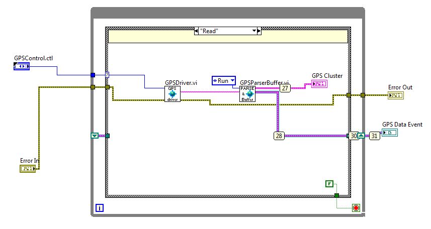

GPS.vi read case. Probe "28" and "30" contain the event number, but Probe "32" does NOT - i suspect this is my problem but im not sure what the issue is.

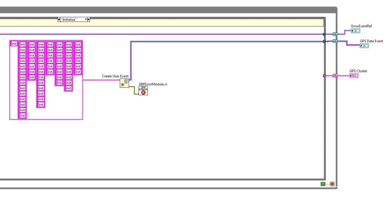

GPSparserbuffer.vi - initialise case where the event gets generated

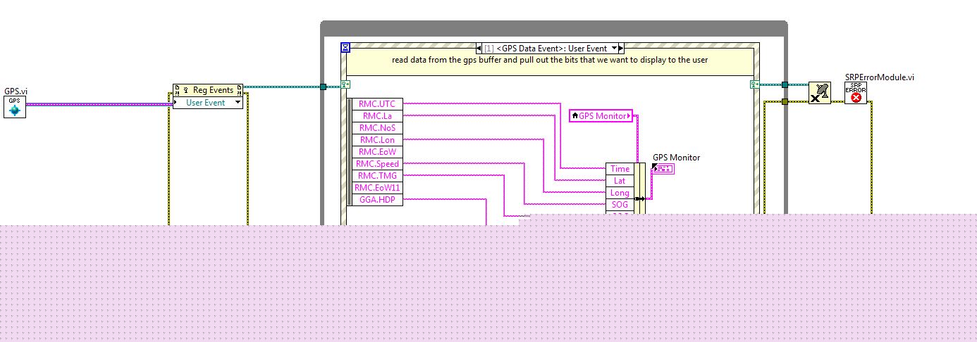

GPS Display code - register for a data event and put select values from GPS cluster into the GPS Monitor indicator.

I ended up sticking with the User event generation - the actual issue was that I had a global functional variable (GPS.vi) that didn't exit on the read case, and so it would get stuck in there and therefore not pass the event generation (or the other data) up to the top level vi to be actioned.
