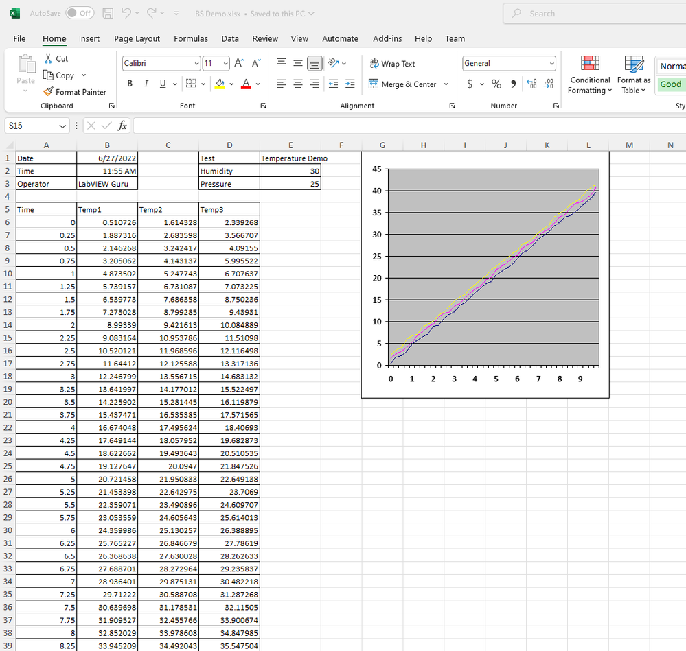

Thank you for the clear explanation.  Yes, you certainly should be able to do what you describe with the Report Generation Toolkit (I've done it myself on several occasions).
How familiar are you with using the RGT?  Do you know how to create a "structured" Excel Report, say something that looks like this?
If not, you can find the source code I posted on the Forum a decade ago -- look for "Revised Generate Excel Report Example".
As you describe what you want to do, I see three steps you need to consider:
  • Gather the data from "Report 1" and "Report 2".  The "easy" way is if the data are not on Excel, but somewhere else (where you used them, perhaps, to write Excel Report #1 and Excel Report #2).  Slightly harder (but not too bad) is to re-acquire the data from the two Excel reports.
  • Decide how you want to organize your two sets of data, especially how you want to organize the various Excel Worksheets.  You might want separate sheets for data from single Reports, and various "combination" pages where you combine the data.
  • Now you can design the output Workbook and Worksheets.  This is usually the simplest step -- you are just writing Excel.
Hope this is helpful.  Good luck with your project.
